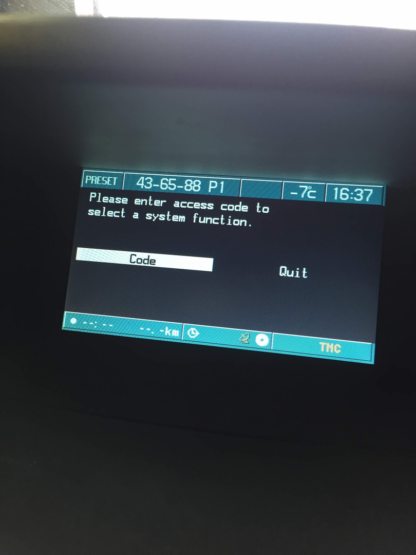

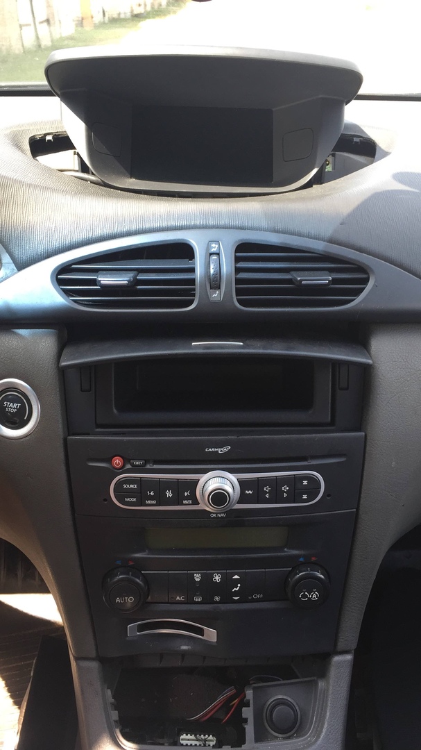

i have laguna 2 ph1 and i have installed cni2, connect all sensors: safety belt, radio switch under the steering wheel, exterior sensor temperature, exit temperature to climate control. all working, but i have some problems:
first problem is that the radio does not correctly interpret the temperature outside the window. radio tape recorder incorrectly interprets the temperature outside the window and displays with a difference of ~ 17 degrees, that is, if it is +15 overboard, the display displays -2.
second problem: I want to get access to the system settings but asks for a four-digit code. "Please enter acces code to select a system function". where can i find it?

Good evening,
the access code to the configuration menu is 4112

I did not know about the display, but I installed the entire panel from phase 2
what about the sensor connection wire, I connected all 3, two from the sensor to the head unit, and one that gives information for the air conditioning computer. I figured out with this moment, but the temperature is not displayed correctly, although everything works correctly with the old display from phase 1
